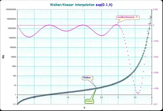

This is not an answer, just an extended comment to the answer of @MarkHunter . The linked article refers to many common topics, but also to something of G. Szekeres and it seems it follows a similar idea as I have seen it in an article of Peter Walker (1970/80). I just implemented that method of Peter Walker (hope I got all right) and compared the results with @SheldonL's Kneser-method.
Just to have an impression of the approximation of the two methods against each other I draw the following picture. Starting at $x_0=0.1$ computing the iterates with heights $h=0..4 $ by $1/40$ steps. The numbers by the two methods are well overlaid (blue & green), however the small differences might still be systematic (pink, y-scale on the right hand). Original differences should be that in the interval $h=0..1$ because the other intervals are computed by the functional equation (at least my version of P. Walkers idea).
I've no further analysis so far.
