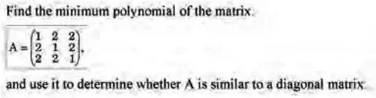

For this problem the eigen values are $5$, $-1$, $-1$ and the minimal polynomial is $x^2-4x-5$.
From eigenvectors, I can see this as diagonalizable.
The question specifically asks to determine it from the minimal polynomial. How do I determine it from the minimal polynomial?

The minimal polynomial $x^2-4x-5=(x+1)(x-5) $ factors completely over $\mathbb R $ into distinct linear factors... This is equivalent to diagonalizability here.
