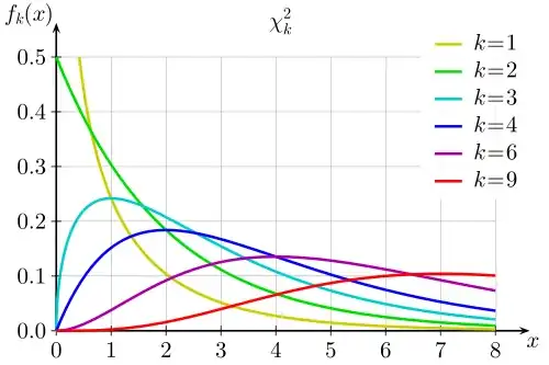

For Chi-squared distribution, different degree of freedom produces different probability density function. Could you explain it intuitively?

Chi-square distribution with $n$ degree of freedom is the sum of squares $n$ independent standard normal distributions $N(0,1)$ hence we've got $n$ things that vary independently.
