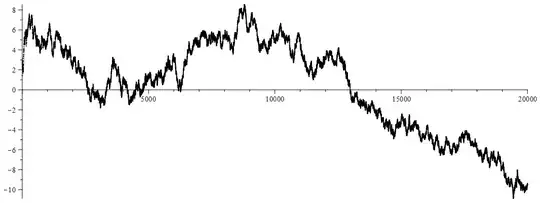

Here's a plot of the partial sums of your series up to $N=20000$. There's no sign of convergence.
{EDIT: new plot using Digits=30]

1I've plotted this in R and my plot looks different than yours. (For example mine dips below the x-axis between $n = 2590$ and $n = 3957$, which doesn't occur in your plot.) And in Python I get numbers that disagree with both this plot and my R-based numbers! I wouldn't have expected numerical issues to rear their head at such relatively small $n$, but I suppose $n^3$ and $(n+\epsilon)^3$ are actually relatively far apart. – Michael Lugo Jul 27 '17 at 17:20
I think computing $\sin(n^3)$ might start with computing $n^3 - 2 k \pi$ where $k = \lfloor n^3/(2\pi) \rfloor$. If doing floating point with $d$ digits, the result will have error about $n^3/10^d$. So for $n > 10^{d/3}$ it's basically all error. I'll redo the plot with Digits = 30. – Robert Israel Jul 27 '17 at 17:52
