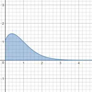

I'm trying to find a closed form for this integral:$$\int_{0}^{\infty}x^{-x}dx$$
Here's the integrand graph:
Clearly it is convergent. My attempt is to obtain a closed form for the area under the curve. Is this possible?

It is highly unlikely that you will be able to find a closed-form expression for your integral. Two special variants of your integral, however, are rather infamous as the "Sophomore's Dream" integrals. They are the integrals $$\int_0^1 x^{x} dx$$ and $$\int_0^1 x^{-x} dx$$ And, as of yet, no closed-form has been obtained for either of them. However, your integral $$\int_0^\infty x^{-x} dx$$ Converges incredibly quickly, even more so than an exponential function, and so a very good approximation can be obtained rather quickly. Wolfram Alpha yields the approximation $$\int_0^\infty x^{-x} dx\approx 1.99545595750014...$$ And so $2$ should be a good enough approximation. Even the inverse symbolic calculator doesn't yield anything for the approximation given by WA, so I doubt that it has any kind of closed form using the elementary functions or any other known constants.
