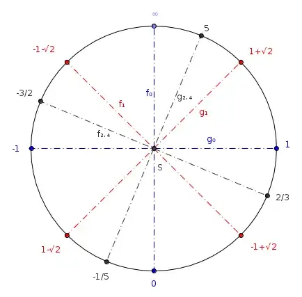

The following picture shows the projectively extended real line as a cross section of the Riemann sphere. Few possible axes are drawn.
I said our functions correspond to certain reflections (or rotations) in 3D. Now in 2D the interpretation is:
  • $f_\alpha$ and $g_\alpha$ correspond to reflections about certain axes;
  • $h$ corresponds to the reflection through the point $S$ (or a half turn, if you wish).
To me the most surprising conclusion is that: $$f_0 (x) \equiv -x$$ and $$g_0(x) \equiv \frac 1 x$$ are more similar than I ever thought.
