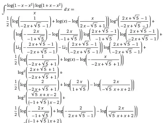

I've calculated the definite integral using the online calculator, but I believe that the output is an approximation, and since after of this, I've asked to Wolfram Alpha about the indefinite integral, I know that Wolfram Alpha can calculate it, but to me is impossible to evaluate the terms (are about two pages)
int log(1-x+x^2)log(1+x-x^2)/x dx

I would say that you can't evaluate it "exactly", because if you go digging through Wolfram Alpha's gigantic monstrosity of antidifferentiation, you will find a lot of logarithmic integrals in there, which are not elementary functions.
It makes sense, too, that this is so ugly, because it will end up going into complex numbers. Your definite integral can be evaluated with less difficulty because $1+x-x^2$ is positive over that interval, but it is negative for all $x$ above the golden ratio and below its conjugate, meaning that $\ln(1+x-x^2)$ does not even exist in the reals over that interval. So calculating the antiderivative is out of the question.

  • The bottom of the formula for the antiderivative seems to have been cut off. – Robert Israel Jul 07 '17 at 20:45
    Presumably there must be terms involving $x - (1 \pm i \sqrt{3})/2$, which are the factors of $x^2 - x + 1$. – Robert Israel Jul 07 '17 at 20:47
    The integrand at the top is slightly different from the OP's (it has $\log(1-x\color{red}-x^2)$ instead of $\log(1-x\color{blue}+x^2)$), but I don't imagine the answer would be much simpler. – Antonio DJC Jul 08 '17 at 05:32
