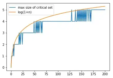

Something I found some months back. Would be surprised if this hasn't been looked at before. No citations.
We say a set $S$ can express $n$ if it's possible to express $n$ as a potentially repeating sum of elements of $S$.
We say that a set $S$ is critical for $n$ if $S$ can express $n$ and no strict subset of $S$ can express $n$.
Let $u_n$ be the size of the largest subset of $\{1,2,\dotsc ,n\}$ that is critical for $n$. It's conjectured that $u_n$ grows like $\log_e n$.
Evidence: enter image description here
