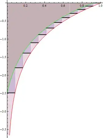

$$ \frac{\log n!}{n} = \log n + \sum_{k=1}^{n} \log\left( \frac{k}{n} \right)\frac{1}{n} $$
and also
$$ \int_{0}^{1} \log x \, dx \leq \sum_{k=1}^{n} \log\left( \frac{k}{n} \right)\frac{1}{n} \leq \int_{1/n}^{1} \log x \, dx $$
by comparing the area as we can see from below:
This shows that
$$ \frac{\log n!}{n} = \log n - 1 + o(1)$$
