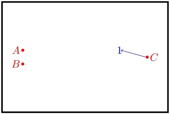

Background: I work for an Ambulance service. We are one of the largest ambulance services in the world. We have a dispatch system that will always send the closest ambulance to any emergency call. There is a belief that this results in the fastest response time as an average across the system.

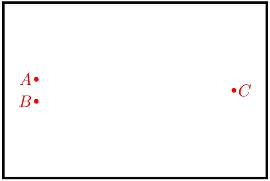

Example: Suppose we have the following simplified scenario. We have 3 ambulances available (labelled A, B and C). At any given point in time, there is an random chance of an emergency call originating equally anywhere inside this box: enter image description here
If an emergency job appears (labelled 1), we will send the closest ambulance (in this case Ambulance C) enter image description here

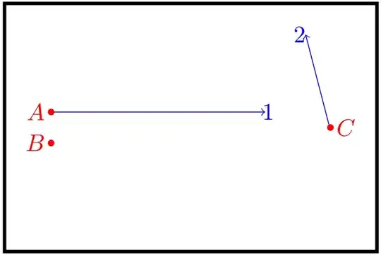

You will notice that Ambulances A and B are very close together on the left side of the box (lets pretend they are just leaving a hospital after dropping off their patients). There is now a large gap on the right. Suppose a small amount of time passes, and another emergency call drops in (labelled 2).

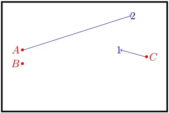

Ambulance C is no longer available, so you must use Ambulance A or B. They have a significantly longer distance to travel to reach incident 2. In this case we have sent Ambulance A to the job.
Hypothesis: If you always send the closest ambulance to an emergency call, you will have the quickest response time to that specific call, but the overall average response time of the ambulance service is not optimised.
Using that hypothesis - it would seem to be better to send Ambulance A or B to the original incident 1. This would mean the the next incident to happen, there will be "on average" a significantly shorter distance for the next ambulance to travel. enter image description here
Question: How can I "prove" this? Is there a mathematical theory or formula? This is obviously a simplifed scenario, there are some other issues - but I just need to prove the fundamental issue that the "closest ambulance being sent to the next incident" actually results in a non-optimal response time across the system as a whole.

If you just want an explicit example, make your second incident happen exactly where C is stationed. Then in the scenario where
A picks up incident 2, C picks up incident 1
the total distance traveled is "distance between 1 and C" plus "distance between A and C" (since 2 is where C is stationed).
In the scenario where
A picks up incident 1, C picks up incident 2
the total distance traveled is "distance between A and 1" plus "distance between C and 2" (which is zero).
So we draw a picture with A, C, and 1 on it. The total distance traveled in the first scenario is two legs of the triangle formed by the three points. The total distance traveled in the second scenario is only one leg of the triangle. By the triangle inequality, the sum of lengths of two legs of one triangle must be bigger than the length of the third. This shows that the total distance traveled in scenario one, which is the "closest responder" scenario", can be non-optimal.

It seems your (mathematical) intuition is wrong, at least under the constraints you specified. Let's firm them up as follows:
  1. The goal is to optimize the average time it takes to reach an incident.
  2. The starting locations of the ambulances are fixed. The question is what order to dispatch them in.
  3. Once an ambulance is dispatched, it is permanently unavailable: It cannot serve other incidents during the same trip, or return to service before the end of the calculation.
Note that after the second ambulance is dispatched, there is only one ambulance left, and it no longer matters where, timewise: There's a 50% chance that the third incident will be in the opposite side of the map. So, the question is: Starting with the 2 : 1 configuration you present, which dispatch strategy will result in the quickest response, on average, over the first two incidents?
The result can be generalized to larger sizes, but the two-incident case is instructive. The answer will surprise you: The nearest-ambulance strategy is better!
A, B ----------------------'---------------------- C
Let's draw a line from A/B to C, and label it as the interval [0, 1]. An incident is a uniformly distributed random variable t in this interval. We can equate response time to distance: If there are ambulances on both sides, the response time to an incident at point t is min(t, 1-t). If ambulance A must be dispatched, the response time is simply t.
The expected value of t, E(t), is 0.5. Obviously t is closer to the left if t < 0.5. It's easiest to consider scenarios by grouping incidents into two random events: Let's call an event L if t is in the left half of the range (t < 0.5), and R if it is in the right half. Then R and L occur with probability 0.5 each.
There can be four two-incident patterns, occurring with equal probability (0.25): LL, LR, RL, RR. If you could always dispatch from the closest side, the expected travel is 0.25 per incident. You incur a cost when you have to dispatch from the wrong side of the map. The expected length of a "long" trip is 0.75.
So, the payoff matrix is:
incidents   dispatch closest   dispatch A
 L L            A, B             A, B
 L R            A, C             A, C
 R L            C, A             A*, B
 R R            C, A*            A*, C
The right column is your proposed strategy: dispatch A first, then whichever is closest. A star means that the ambulance had to make a long trip (from the wrong side of the map) to get there. Note that there are more stars (penalties) on the right column.
The fourth row in the table is the one you're worried about: What if there's another incident on the right side of the map, after you've dispatched C? The answer is, don't worry! The bottom row has exactly the same cost under the two strategies: When you dispatched A to the first incident, you already incurred the cost you were trying to avoid in the second incident.
But the third case is one you didn't factor in: What if you send A on a long trip, and then C is not needed after all? In this case, dispatch-A will take longer than the dispatch-closest algorithm.
Since dispatch-A is not better under any scenario, dispatch-closest is superior on average.
Informal summary: If C is closer but you dispatch A, as you propose, you incur a penalty equal to the benefit you will reap if the next incident is nearer to C. So you would break even at best. But the next incident might be closer to A, and you'll never get to collect on your investment. Conclusion: Dispatching the closest ambulance is the better strategy. You can only do better by improving the distribution of ambulances before the second call comes in, as various others suggested. Once the phone rings, sending the closest car is in fact globally optimal.
