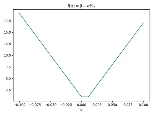

Plots of $f$: I ran two simple numerical examples which might be enlightening. In the following plot 1, $X = I\in M_{50}(\mathbb{R})$ and $Y = Z^\mathsf{T}Z + I$ where $Z_{ij}\sim\mathcal{N}(0,1)$ is normally distributed. As we can see, the plot seems piecewise linear. plot of f using

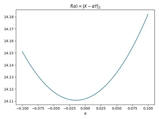

In the next plot 2, we take $X_{ij}\sim\mathcal{N}(0,1) - I \in M_{50}(\mathbb{R})$ and $Y_{ij}\sim\mathcal{N}(0,1)$. Note that neither $X$ nor $Y$ are symmetric. This example looks differentiable and practically quadratic.enter image description here
