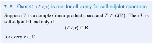

The answer to your question is NO. (And it is worse in the complex case: if a matrix $A$ is not Hermitian, then it is impossible that $x^TAx\geq 0$ for all $x$.)
In the setting of complex vector spaces, if $x^TAx\geq 0$ for all complex vectors $x$ (your definition of semi-definite), which in particular implies that $x^TAx\in{\bf R}$, the following theorem in Axler's Linear Algebra Done Right shows that $A$ must be Hermitian (if $A$ is real, then $A$ must be symmetric):
