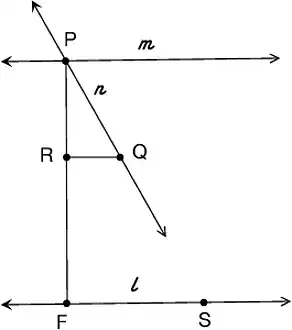

Proof of EPP from Wallis's Postulate: Suppose we have a line $\ell$ and a point $P$ not on the line. We can drop a perpendicular from $P$ to line $\ell$ and let the perpendicular intersect $\ell$ at point $F$. Then construct a new line $m$ at $P$ at $90$ degrees to our perpendicular. This new line will be parallel $\ell$. If it were not, $m$ and $\ell$ would intersect forming a triangle which would violate the exterior angle theorem.
It remains to show the line $m$ is unique. Suppose there were a different line $n$ also through $P$. We must show $n$ is not parallel, that is, line $n$ intersects $\ell$.
If $n$ is our perpendicular $\overleftrightarrow{PF}$ obviously it intersects $\ell$. So if $n$ is not $\overleftrightarrow{PF}$, lets choose a point $Q$ of $n$ between lines $\ell$ and $m$ but not on $\overleftrightarrow{PF}$. Let $R$ be the point of intersection of a perpendicular dropped from $Q$ onto line $\overleftrightarrow{PF}$. Let $r=\frac{PF}{PR}$. Wallis's theorem assures us that there is somewhere a triangle $\triangle ABC$ that is similar to $\triangle PQR$ with scale factor $r$. We can construct a new triangle $\triangle PSF$ on the segment $\overline {PF}$ congruent to $\triangle ABC$ by placing $S$ on $\ell$ at distance $BC$ from $F$ and on the same side of $\overleftrightarrow{PF}$ as $Q$. This triangle is congruent to $\triangle ABC$ by the side-angle-side congruence theorem and so is similar to $\triangle PQR$. So the angles $\angle FPS$ and $\angle RPQ$ are the same angle. Hence the lines $n$, $\overleftrightarrow{PQ}$, and $\overleftrightarrow{PS}$ are the same line, and $n$ does indeed intersect $\ell$. $\square$
Wallis to EPP diagram
