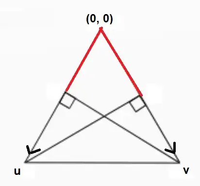

and that $\sqrt {<v,v>}$ better represent the length of a vector $v$. The one thing that needs work to get it to all fall out is the commutativity , $<u,v>=<v,u>$, but working with (1) you construct the isosceles triangle:
and you want to show that the red line segments are of equal length.

  • I like your idea about starting with projections. But I'll need to think for a bit about how to go about it exactly, because the way you define a projection here requires that you already have some kind of inner product. – Inzinity Jun 07 '17 at 20:06
  • When you set up the coordinate Cartesian Plane you want to use algebra to demonstrate geometric concepts. You can accept Pythagorean theorem to take the length of vector, but you are still have to handle angles. You are searching for a cool way to get both together without having to analyze a circle. – CopyPasteIt Jun 07 '17 at 22:40
