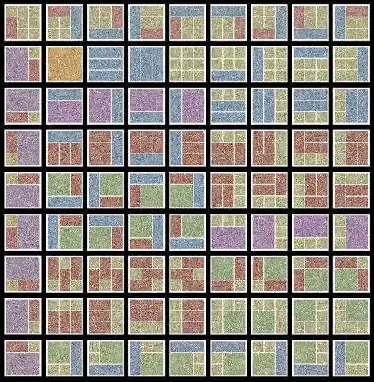

While writing my answer to Why does “Watchmen” use the 9-panel grid? I used this picture to indicate the many ways it can be divided into groups (which may be used for the panels of a comic, as was the case in “Watchmen”):
Image source
Afterwards, it has been pointed out to me in a comment that there are some combinations that are not present in this picture:
The $81$ variations on the $9$ panel grid in that diagram don't exhaust the possibilities -- there are certainly many others. For example, this one is one of the many that aren't shown there.

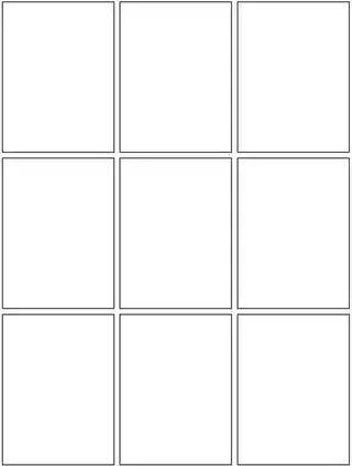

Another comment says that the 9-panel grid can be used in $4096$ different ways:
The are $12$ interior borders, each of which can be included or excluded in a particular layout. That's $2^{12} = 4096$ possibilities.
A two-page spread treats two $3 \times 3$ grids as a single $6 \times 3$ grid with $21$ internal borders, for $2,097,152$ possibilities.
How can I calculate that? I tried the following:
  • There a $3$ ways to group the third row.
  • That leaves us with $4$ panels in 2nd and 3rd rows. I count $4$ ways to group those.
  • The $12$ combinations so far must be multiplied by $4$ (because I can rotate them) and by $2$ (because I can mirror them).
This gives me $96$ variations. The picture above has $81$; the comment said there are $4096$.
Is there a layman-friendly geometrical solution? I'm not really interested in a precise value (a lot is enough for me), I'm more interested in the technique or a rule. Is there a general rule for a n-by-n grid?
To clarify: panels must be rectangular, i.e. they must be formed by merging some of the $9$ panels horizontally or vertically:

Suppose we create a layout by deleting borders between the panels of a $3\times 3$ grid, as has been suggested at various times. But let's put some restrictions on which borders we can delete so that no non-rectangular panels are possible, but all layouts with rectangular panels are possible.
Consider the four border segments that meet at a single vertex in the $3\times 3$ grid. Label these segments $N, E, S, W$ in clockwise order starting from the top. If you delete three of these segments and leave one intact, you end up with a panel with a "crack" in it, not a rectangle. There are $4$ forbidden arrangements of this kind. If you delete two "adjacent" segments such as $N, E,$ you end up with a panel that has a "concave" corner, again not a rectangle. That gives us another $4$ forbidden arrangements.
But any of the other $16 - 4 - 4 = 8$ combinations of border segments around a common vertex can occur in a layout consisting purely of rectangles. Call these the permitted combinations.
It seems "obvious" (though maybe not so obvious how to prove) that as long as all four vertices in the interior of the grid have permitted combinations of edges, the layout will consist only of rectangles.
Actually counting the combinations that can occur together is more complicated. It's not $8^4,$ because there are many ways the choice of combination of edges at a vertex can be restricted by the combinations at the adjacent vertices.
To enumerate the possibilities, consider the edges that might or might not exist around the central square of the $3\times 3$ grid.
Case 1. All four edges exist. So the $NE$ vertex of this square has at least $W$ and $S$ edges; there are $3$ permitted combinations of the the other two edges. Similarly, there area $3$ permitted combinations at each of the other three vertices of the central square. This gives us $3^4=81$ possible layouts.
Case 2. Three edges exist. To begin with, we have $4$ choices of which edge to delete. Then, at each of the two vertices adjacent to the deleted edge, there are exactly $2$ permitted combinations of edges. (For example, if we delete the $E$ edge of the central square but not its other three edges, the $NE$ vertex has edge $W$ but not edge $S$; it must therefore have edge $E$ but edge $N$ is optional.) At each of the other two vertices, there are still $3$ permitted combinations. Altogether, there are $4 \times 2^2 \times 3^2 = 144$ layouts of this kind.
Case 3. Two opposite edges exist, the other two are deleted. There are $2$ ways to choose which pair of edges to delete around the central square; at each of the four vertices there are then $2$ permitted combinations of edges. Altogether there are $2\times 2^4 = 32$ layouts of this kind.
Case 4. Two adjacent edges exist, the other two are deleted. There are $4$ ways to choose which pair of edges to delete around the central square. At the vertex with two edges there are then $3$ permitted combinations of edges; at each of the two vertices adjacent to that, there are $2$ permitted combinations of edges; and at the fourth vertex (the one with two adjacent deleted edges already) all four edges must be deleted. Altogether there are $4\times 3 \times 2^2 = 48$ layouts of this kind.
Case 5. One edge exists. We have $4$ choices of which edge this will be. Then, at each of the two vertices adjacent to the remaining edge, there are exactly $2$ permitted combinations of edges. The other two vertices already have two adjacent edges deleted, so they each must have all four edges deleted. Altogether, there are $4 \times 2^2 = 16$ layouts of this kind.
Case 6. No edges exist around the central square. There is only one layout with this property, the one consisting of a single panel.
Adding it up, we have $$ 81 + 144 + 32 + 48 + 16 + 1 = 322,$$ so there are $322$ possible layouts.

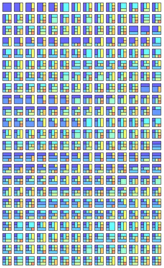

While this is not so much of a mathematical solution as a software one, I'm going to add it anyway, if only for the nice image at the end.
The process used to find all of the grids is as follows.
First of all each of the squares on the 3x3 grid is assigned a index 1 to 9 based on the coordinate ($n=3(y-1)+x$), where $(1,1)$ is top-left and $(3,3)$ is bottom-right. This number represents the highest index of a panel which can cover it.
Essentially this means that panels must grow out from any square rightward and downward. This limitation prevents duplicate entries - every panel which grows right-down is identical to one which grows left-up.
The task is then to simply build up a list of possible grids by adding panels. The panels are using a recursive approach which abandons all grids which could only be covered have more than one panel with the same index thus preventing duplicates grids.
For anyone interesting is seeing the MATLAB code which enumerated all the grids, I've including it at the end of the answer.
It's quite impressive how fast the number of possible grids grow.
For a 3x3 grid we have the 322 possibilities as was identified by the other answers. Jumping up to 4x4 gives 70878 possible grids. Going for a two page spread of 3x6 the number increases to a barmy 314662 possible grids!
Having built all possible grids, it only makes sense to export them into something pretty. Below is all of the grids tiled and converted to a combined image of all 322 possible grids. In the image the colour of a panel represents the index of top left square in that panel.
All 322 Grids
The grids are sorted in the order that they were found - which is essentially one of starting with a solid square and then working back from the bottom right corner.
The following MATLAB functions are used to produce the grids.

The following script is then used to call the function and create the tiled image (although I added the borders with edge detection in Photoshop)
%Grid Size
x=3; %3x3
y=3;
%Enumerate all grids
grids=makeGrids({},zeros(x,y),1,x,y);
gridCount = numel(grids);
disp(['Grids Found: ' num2str(gridCount)]);
%Colour mapping for image - hot(x*y), hsv(x*y) and jet(x*y) all look good
map=[jet(x*y);0,0,0]; %;0,0,0 is for black borderd
%Create images for all grids
nameFormat = ['%0' num2str(ceil(log10(gridCount))) 'd'];
for i=1:gridCount
    img=grids{i};
    img(x+1,:)=(x*y)+1;
    img(:,y+1)=(x*y)+1;
    [img, newmap]=imresize(img,map,32,'nearest');
    imwrite(ind2rgb(img,newmap),['Grid' num2str(i,nameFormat) '.png']);
end
%Create tiled montage of images
dirOutput = dir('Grid*.png');
fileNames = {dirOutput.name}';
vertical = max(factor(gridCount));
horizontal = gridCount/vertical;
montage(fileNames, 'Size', [vertical horizontal]);
%And save montage as PNG.
allGrids=getframe(gca);
imwrite(allGrids.cdata,'AllGrids.png');

    Wow! Thanks for the MATLAB code! I think I'd understand it better than any mathematical explanation. – Gallifreyan May 20 '17 at 10:56
  • Heh - tried running the code for a 4-by-4 grid - takes very long. I'll try and see if I can make it use parfor loops. – Gallifreyan May 20 '17 at 11:24
    @Gallifreyan Yep, quite amazing how fast the pool grows. I tried to optimise the code to eliminate checking quite a lot of invalid grids. I've just finished running it for a 6x3 grid (2 pages). Took about 2 hours, result: 314662 possible grids! – Tom Carpenter May 20 '17 at 11:26
  • @Gallifreyan 70878 possible combinations for a 4x4 grid. – Tom Carpenter May 20 '17 at 11:51
  • Yep, mine just finished. Still waiting for the picture to generate though (I wonder if it'll break my computer. Should've done it on the bigger laptop.) – Gallifreyan May 20 '17 at 12:13
  • @Gallifreyan you could be there for quite some time generating the picture. Not sure it will be worthwhile as MATLAB will shrink it down to fit on the screen (I tried with 3x4 but it didn't look great). I've finally got the 314000 images for 6x3 saved. Trying to use imagemagick to montage them instead of MATLAB. – Tom Carpenter May 20 '17 at 12:22

  • Do you mind if I use your picture in my Watchmen answer? With attribution, of course. – Gallifreyan May 21 '17 at 10:14
    @Gallifreyan you're welcome to.. – Tom Carpenter May 21 '17 at 10:16

  • Since the grid is square (n x n) I thought that "divide and conquer" would work well - just multiply by 4. But I see your point. – Gallifreyan May 19 '17 at 16:52
  • Since you got 300 and David got 322, you might consider reviewing yours and his answer to see which of you have made a mistake :) – Shufflepants May 19 '17 at 21:15
    1x3 + 1x3 + 1x2 -> 1 (8) + 1(4) because the 1x2 can be in the middle row as well – Octopus May 19 '17 at 22:12
    I fixed four mistakes, and now it matches David K's answer. I had overlooked some patterns, such as the one @Octopus found, and the pattern with a 1x1 in the centre surrounded by four dominoes. – Jaap Scherphuis May 20 '17 at 01:42
    This is the closest yet to the general answer. Nice use of matrices too. – David K May 20 '17 at 04:15
  • Computing the Jordan form of the matrix gives an asymptotic formula for the sequence $4, 34, 322$, namely $a_n \sim \alpha \lambda^k$, where $\alpha = 3.114!\ldots$ is a particular algebraic number of (it looks like) degree $14$ and $\lambda = 10.018!\ldots$ is the largest of the three real roots of $x^3 - 15 x^2 + 55 x - 51$, the irreducible cubic factor of the characteristic polynomial of the $4 \times 4$ matrix – Travis Willse May 21 '17 at 13:02
For square grids, the "Number of ways of dividing an $n\times n$ square into rectangles of integer side lengths" is OEIS sequence A182275. There are no formulas, but for $n\le12$ the following numbers have been calculated by Joshua Smith and Helena Verrill:
1 1
2 8
3 322
4 70878
5 84231996
6 535236230270
7 18100579400986674
8 3250879178100782348462
9 3097923464622249063718465240
10 15657867573050419014814618149422562
11 419678195343896524683571751908598967042082
12 59647666241586874002530830848160043213559146735474
See also A034999 for $2\times n$ grids and A116694 for $m\times n$ grids.
