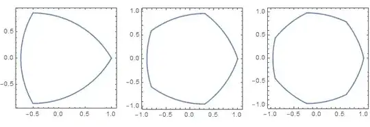

I derived a parametric formula for Reuleaux polygons some time ago in this blog entry.
To make this post self-contained, here are the equations:
$$\begin{align*} x&=2\cos\frac{\pi}{2n}\cos\left(\frac12\left(t+\frac{\pi}{n}\left(2\left\lfloor\frac{n t}{2\pi}\right\rfloor+1\right)\right)\right)-\cos\left(\frac{\pi}{n}\left(2\left\lfloor\frac{n t}{2\pi}\right\rfloor+1\right)\right)\\ y&=2\cos\frac{\pi}{2n}\sin\left(\frac12\left(t+\frac{\pi}{n}\left(2\left\lfloor\frac{n t}{2\pi}\right\rfloor+1\right)\right)\right)-\sin\left(\frac{\pi}{n}\left(2\left\lfloor\frac{n t}{2\pi}\right\rfloor+1\right)\right) \end{align*}$$
Here is a Mathematica demonstration:
Table[ParametricPlot[2 Cos[π/(2 n)] Exp[I (t + π (2 Floor[n t/(2 π)] + 1)/n)/2] -
                     Exp[I π (2 Floor[n t/(2 π)] + 1)/n] // ReIm, {t, 0, 2 π}],
      {n, 3, 7, 2}] // GraphicsRow
Reuleaux polygons
(Note the use of the complex form of the parametric equations.)
For some applications, a polar equation (like the one in this answer) might be more convenient. One can use the usual distance formula in polar coordinates to derive the polar equation of an $n$-sided Reuleaux polygon:
$$r=\cos\left(\theta -\frac{2\pi}{n}\left\lfloor\frac{n (\theta -\pi )}{2 \pi }+\frac{1}{2}\right\rfloor\right)+\sqrt{1+2\cos\frac{\pi}{n}+\cos^2\left(\theta -\frac{2\pi}{n}\left\lfloor\frac{n (\theta -\pi)}{2 \pi}+\frac{1}{2}\right\rfloor\right)}$$
In Mathematica, one can do this:
Table[PolarPlot[With[{c = Cos[θ - 2 π Floor[n (θ - π)/(2 π) + 1/2]/n]},
                     c + Sqrt[1 + 2 Cos[π/n] + c^2]], {θ, 0, 2 π}],
to get a picture identical to the one above.
As you can see from the diagram below, if $L$ is the length of a side of the regular polygon, $n$ (odd) the number of its sides and $W$ its width, then:
$$L=2W\sin{\pi\over 2n}.$$

  • While this is good to know, it doesn't give me the information I'm looking for. I've updated the initial post to clarify what I need. – GPHemsley May 13 '17 at 23:58
  • The angle between two sides is $(n-2)\pi/n$, as in all regular polygons (I'm using radians for the angles, here and above). Then, as explained on the Wikipedia page, you must draw an arc on every side, centered at the opposite vertex. And the number of vertices $n$ must be odd. – Intelligenti pauca May 14 '17 at 06:32
  • I think your answer along with this coordinate calculation tool is giving me what I need. Is it true that a Reuleaux polygon with a relatively small number of sides will quickly approximate a circle? Is this relationship accurately represented by $nL$ vs. $W\pi$? – GPHemsley May 14 '17 at 08:07
  • As you can see in the above diagram, already for $n=7$ a Reuleaux polygon can be hardly discerned from a circle. $nL/(W\pi)$ could be a good indicator of this approximation: by the above formula this is the same as $\sin(x)/x$ with $x=\pi/(2n)$ and it quickly tends to $1$ for $n\to+\infty$. – Intelligenti pauca May 14 '17 at 08:29
