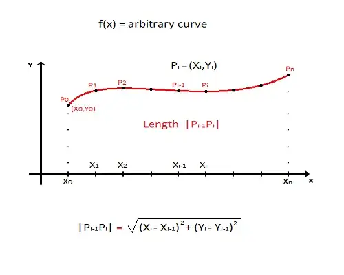

Take a look at the following graph of an arbitrary curved defined by some function $f(x)$.
graph of curved function
The graph above shows the formula for finding the approximate length of each of the line segments $P_{i-1}P_i$. We can approximate the total length of the curve through summation by the following formula.
$$L\approx\sum_{i=1}^n \lvert{P_{i-1}P_i}\rvert$$
We can write the distance formula as:
$$\lvert P_{i-1}P_i\rvert = \sqrt{\left(\Delta x\right)^2 + \left(\Delta y\right)^2}$$
We know that $\Delta x = x_i-x_{i-1}$ and $\Delta y = y_i-y_{i-1}$.
However, we know that for every $\Delta x$ its length doesn't change, but for every $\Delta y$ it depends on $\Delta x$.
Let $\Delta y_i = y_i-y_{i-1}$ and the distance formula now becomes:
$$\lvert P_{i-1}P_i\rvert = \sqrt{\left(\Delta x\right)^2 + \left(\Delta y_i\right)^2}$$

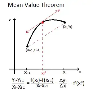

With the distance formula written in this form we can now use the Mean Value Theorem show below:
mean value theorem
Therefore:
$$f'\left(x_i^*\right) = \frac{\Delta y_i}{\Delta x}$$
$$\Delta y_i = f'\left(x_i^*\right)\Delta x$$
