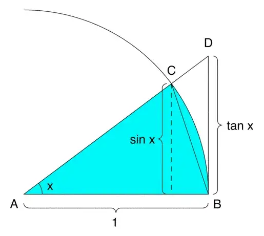

Hint to prove it yourself:
Let $A_1$ be the area of triangle $ABC$, $A_2$ be the area of arc $ABC$, and $A_3$ be the area of ABD. Then we have:
$$A_1<A_2<A_3$$
Try and find expressions for $A_1,A_2,$ and $A_3$ and fill them into the inequality and finally use the squeeze theorem.

  • The figure here seems to be same as that in the classic answer by moderator rob John. Do visit https://math.stackexchange.com/a/75151/72031 for more discussion on this limit. – Paramanand Singh May 12 '17 at 06:40
  • Just realized this. I googled image illustration for sinx/x proof and this one was the best, didn't know it was from math stack exchange. – AspiringMat May 12 '17 at 06:47
  • The advantage of this approach is that it can be presented with least amount of mathematical machinery and is suitable for students who are beginning to learn calculus. The only deep result needed is that every sector of a circle has an area and that area of a region is not less than area of a sub-region. Also contrary to what many believe the proof is as rigorous as a proof can be. – Paramanand Singh May 12 '17 at 06:57
