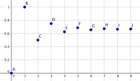

Here's yet another way to look at the problem, that might not lead directly to a proof, but might give intuitive insight into the sequence.
Note that from $x_0$, we go $x_1-x_0$ up to $x_1$, then $\frac12(x_1-x_0)$ down to $x_2$, then $\frac14(x_1-x_0)$ up to $x_3$, etc. You might be able to prove this by induction, but might not want to. If $x_0=0$ and $x_1=1$, one can put this in a picture: ($A=(0,x_0)$, $B=(1,x_1)$, ...)
half-powers plot
We conclude that, since the jump from $x_0$ to $x_1$ can really be seen a a jump of $1=(-1/2)^0$ relative to $x_0$:
$$x_n = x_0 + (x_1-x_0)\sum_{i=0}^{n-1} \left(-\frac12\right)^i$$
Then the limit for $n \rightarrow \infty$ is:
$$\lim_{n\rightarrow\infty} x_n = x_0 + (x_1-x_0)\sum_{i=0}^\infty \left(-\frac12\right)^i = x_0 + (x_1-x_0)\frac1{1+\frac12}$$
by the geometric series (since $\lvert-\frac12\rvert < 1$). Then this is equal to:
$$\begin{align*} x_0 + (x_1-x_0)\frac1{1+\frac12} &= x_0 + \frac23(x_1-x_0) = \frac{3x_0+2x_1-2x_0}3 \\ &= \frac{x_0 + 2x_1}3. \end{align*}$$
