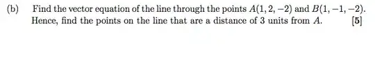

I was wondering if anyone could shine some light on the correct thought process for this problem.
The vector equation can be expressed as the following:
$$r = a + t(b - a)$$
If I want to find a point on this line, I look to $r$. In addition, I can relate each projection of $r$ in the $x, y$ and $z$ axes using:
$r_x = a_x + t(n_x)$
$r_y = a_y + t(n_y)$
$r_z = a_z + t(n_z)$
However, how can I tweak these values to satisfy them being 3 units away from A? Do I make $r_x = 3 - a_x$ for each axis? If not, why does that not work? I feel like that would be logical, but I don't know how that could get me anywhere. Would appreciate any guidance on how to express this condition asked for in the problem.
sangstar
  • 1,947
"A direction" of the line $\overleftrightarrow{AB}$ is $B-A=(0,-3,0)$.
(Another direction is $A-B$. But we won't use that.)
So every point on the line $\overleftrightarrow{AB}$ can be expressed as
$$P(t)=A +t(B-A) = (1,2,-2)-t(0,3,0)$$
The distance between the point $P(t)$ and $A$ is $||P(t)-A||=||t(0,3,0)|| = 3|t|.$
So the points on the line that are a distance of $3$ from $A$ satisfy the equation $3|t|=3$. Hence $t\in \{1, -1\}$.
The points are $(1,2,-2) \pm (0,3,0)$
