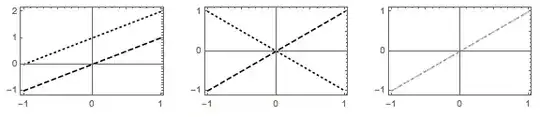

There are three possible cases for $2$ linear equations with $2$ unknowns (slope and intercept):
$\qquad$ $\mathbf{0}$ solution points $\qquad$ $\qquad$ $\mathbf{1}$ solution point $\qquad$ $\qquad$ $\mathbf{\infty}$ solution points
$\qquad \quad$ $\nexists$ no existence $\qquad$ $\qquad$ $\exists !$ uniqueness $\qquad$ $\qquad$ $\exists$ no uniqueness
The lines have the form $y(x) = mx + b$.
Case 1: parallel lines
A solution does not exist.
The lines are parallel: they have the same slope.
$$ % \begin{align} % y_{1}(x) &= m x + b_{1} \\ % y_{2}(x) &= m x + b_{2} \\ % \end{align} % $$
Case 2: intersecting lines
We have existence and uniqueness.
The slopes are distinct.
$$m_{1} \ne m_{2}$$
$$ % \begin{align} % y_{1}(x) &= m_{1} x + b_{1} \\ % y_{2}(x) &= m_{2} x + b_{2} \\ % \end{align} % $$
Case 3: coincident lines
We have existence, but not uniqueness. There is an infinite number of solutions. Every point solves the system of equations.
Both lines are the same.
$$ % \begin{align} % y_{1}(x) &= m x + b \\ % y_{2}(x) &= m x + b \\ % \end{align} % $$
