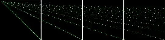

Let $x_0,y_0$ be nonnegative integers. Let $P_n(x_0,y_0)$ be a $n$ by $n$ matrix "of point $(x_0,y_0)$" whose top left entry is denoted with $P_n(x_0,y_0)(0,0)$ and whose bottom right entry is denoted with $P_n(x_0,y_0)(n-1,n-1)$. It is defined for $x,y\in[0,n)$ as:
$$ P_n(x_0,y_0)(x,y)= \begin{cases} 1, & \text{if }x+nx_0\text{ is a two digit palindrome in base }y+ny_0\\ 0, & \text{else} \end{cases} $$
We can visualize these "point" matrices as images by coloring different entries with different colors. For example, "$P_{100}(x_0,y_0)$"'s for $(x_0,x_0)=(0,0),(1,0),(2,0),(3,0)$ are:
Where the green pixels represent the matrix entries that are $1$.
Notice that $P_n(x_0,y_0)$ in point $(x_0,y_0)=(0,0)$ contains "dotted lines" $L_t$ of points from
$$\{(t^2-1+(t-1)r,t+r),t\ge 2, r\ge 0\}$$
and that if we look at $P_n(x_0,y_0)$ in some other point, we get continuations of these lines.

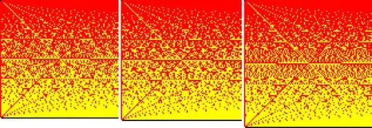

"Heat-image" matrix of prime number $p$
We will write $\overline{N}_p=h(N_p(1))$ and call $\overline{N}_p$ the "heat-image of prime $p$", where $h$ assigns distinct colors to distinct values of entries of $N_p(1)$ and returns such matrix. Let the zero value be "black", the smallest nonzero value be "red" and the second-smallest nonzero value be "yellow". Other values can be "white" or represented in shades of "grey".
For example, here are $\overline{N}_p$'s of primes $p=101,103,109$:
At first glance these appear to be different sizes of the same image, but this is not the case.
Within different $M_p$'s we find different patterns in certain regions of the image. Thanks to Hyperplane's comment, we can "enhance" these regions by removing the needless details.
That is, if we ignore the last row then these $\overline{N}_p$'s appear to be symmetric along the central horizontal line. In other words, if an entry $(x,y)$ is red then the mirrored entry $(x,|p-y-2|)$ is yellow, and vice versa. However, this is not true for all entries.

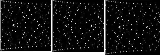

We will observe the irregularities in the "heat-image". That is, we define a new matrix $M_p$:
$$ M_p(x,y)= \begin{cases} 1, & \text{if }N_p(1)(x,y) = N_p(1)(x,|p-y-2|)\\ 0, & \text{else} \end{cases} $$

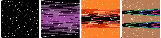

We will represent these entries by coloring $1$'s and $0$'s with white and black, respectively.

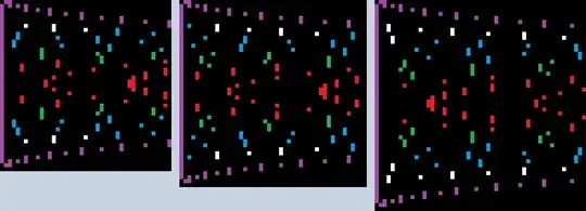

For example, here are $M_p$'s of primes $p=101,103,109$:
Observe the white pixels near the central horizontal line. Notice that there we can distinguish between a "thick dotted parabola" and a "thin dotted parabola".
For example, zooming into the central horizontal line of $109$ shows
that the "thick dotted parabola" one is on the left side, and that the "thin dotted parabola" one is on the right side. It is the same for the prime $101$, but not for the prime $103$ which has it the other way around.
It turns out that primes of the form $p=4k+1$ are "left-handed" (have the "thick" parabola on the left side) and that the primes of the form $p=4k-1$ are "right-handed" (have the "thick" parabola on the right side).

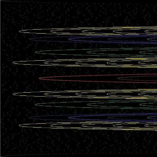

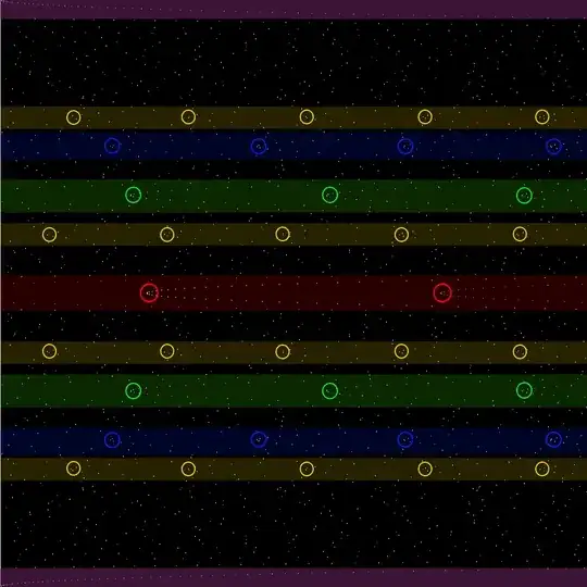

For example, in primes as large as $p=997$ I've highlighted four of these regions. Some regions repeat multiple times. For example, notice that there are four instances of the yellow region highlighted.
If the picture above isn't clear, we can alternatively color (highlight) the regions by connecting the pixels (entries) that represent ("belong to") corresponding "parabolic" shapes:
In every region $R$, we can observe a set of "parabolic" shapes. Different permutations of those shapes will appear in different primes $p$ (in different $M_p$'s), depending on the remainder $m$ from division of $p$ by some constant $c_R$.

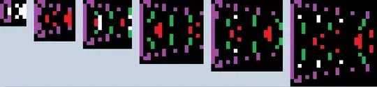

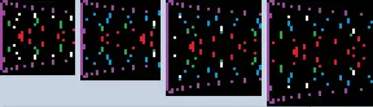

I've decided to color $R_1,R_2,R_3,R_4$ with $\color{purple}{\text{purple}},\color{red}{\text{red}},\color{green}{\text{green}},\color{blue}{\text{blue}}$, respectively. I'll use white to color pixels that "overlap" (could be in either region) or those that "are forming next region".
Prime numbers $p=2,3,5$ seem too small so we can start with $p=7,11,13,17,19,23$.
The first three regions are already visible in these small primes.
Observing the next few primes $p=29,31,37,41$, we see that the fourth region emerges too, but still intersects the third region at some parts.
It is at primes $p=43,47,53$ when the fourth region should be clearly visible for the first time.
The fifth region and beyond will appear at a bit larger primes.
