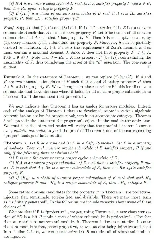

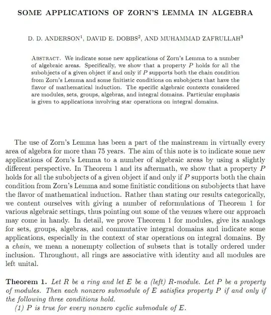

I suspect you'll find highly interesting the following paper on related topics, which I mentioned in some prior answers that you may find of interest. Below is the introduction of said paper. enter image description here enter image description here enter image description here
Bill Dubuque

  • I've just read this introduction. It's really interesting. Thank you very much! I think I see the link between Theorem 1 and the proof of the characterization of semisimple modules: "a module is direct sum of simple modules iff every submodule has a complement". I will download & print the paper, and I'll try to read and think it through when I have more time. Thank you again, your intuition was right, I do find this highly interesting! – Bruno Stonek Jan 17 '12 at 13:31
