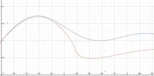

As a simple illustration, consider the function $f(x)=1+\sin x$ and fix the lower bound $a=0$. On the following graph the $x$-axis represents the upper bound of integration $b$, and on the $y$-axis are represented the the arithmetic mean (blue) and the geometric mean (red) of $f$ on the interval $[a,b]$ where $a=0$ and $b=x$.
Clearly the claimed inequality seems to hold, and is in fact quite tight when $b\approx0$.
