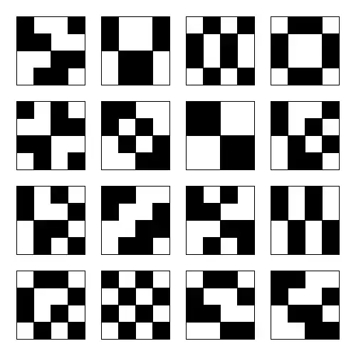

When $n=2$, there are $16$ valid $4\times 4$ grids, shown below:

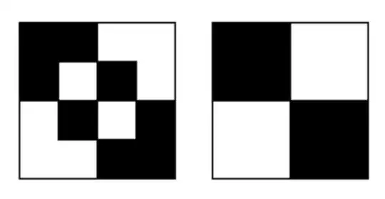

As a lower bound, note that one can tile a $4k\times 4k$ board with either of the following two tiles in each $4\times 4$ subsquare:
This gives a lower bound of $2^{n^2/4}$, compared to the trivial upper bound of $2^{4n^2}$, so we certainly know that it grows like $\exp(O(n^2))$.
