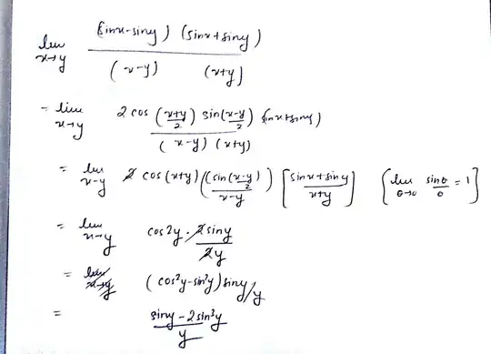

first replace limit from x~y to x-y~0 then apply L'Hospital rule...you can also proceed like this enter image description here
