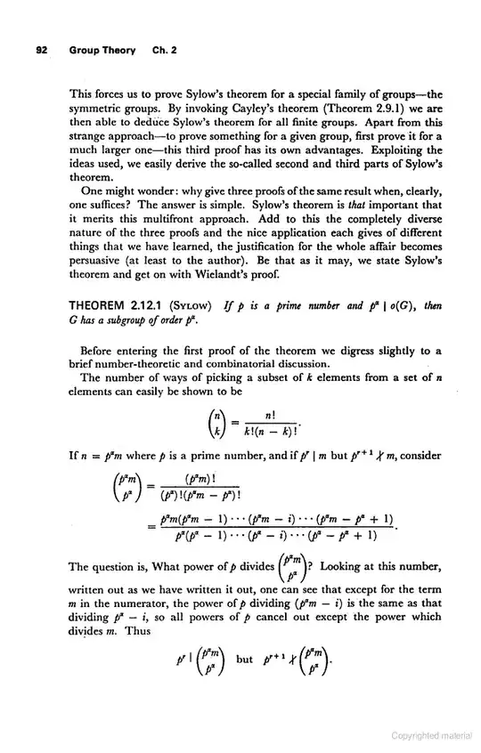

This is the same idea which I.N.Herstein uses to prove the First Sylow theorem. So i would recommend you to have a peep into his, Topics in Algebra book, Sec 2.12, Group Theory, Page 92 enter image description here
