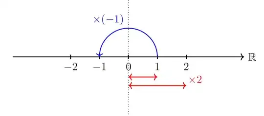

  • I think a young student will recognize that multiplying a positive number by $-1$ has the effect of "flipping" that number across the origin on the number line. It is a matter of convincing the student that multiplying a negative number has (or should have) the same effect. – Umberto P. Apr 14 '17 at 13:45
For a primary school perspective, I like to imagine it as an enlargement of some kind. For example, picture the number line. Then $1 \times 2 = 2$ since $2$ doubles $1$ --- you can see this because $1$ moves up the number line from $0$ twice as much. Multiplication by $-1$ is a reflection in the number line at zero --- every positive number jumps over zero to get to it's negative counterpart. Now, if you reflect $-1$ in the same way, what do you get? You're back to $1$!
Bilbottom
  • 2,658
  • 33
  • You might want to say that multiplying by $-1$ turns you around rather than reflects to be even simpler. Maybe talk about a car going forwards and backwards. – badjohn Apr 14 '17 at 13:52
  • @badjohn I agree, that could also be useful --- I just know that for me, reflections are easier to picture. Both interpretations work, it's just whichever works for the recipient! – Bilbottom Apr 14 '17 at 14:03
  • I suspect that you are slightly past primary school age. I guessed that "turn around" would be simpler since a child can actually do that. "Reflect yourself" would be hard to obey. Feedback from the OP after he tries would be interesting. – badjohn Apr 14 '17 at 14:06
