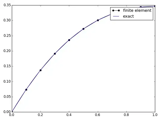

Your finite element solution is not correct. For this kind of problem (1 -dimensional problem, constant material parameter) the finite element solution should be exact at the vertices. So the floating point numbers in your lists should be equal.
It's hard to say where the error is without seeing your full code. Some possible errors:
  • Wrong load vector. I don't know how you evaluated yours, I usually do it using numerical quadrature so I don't use any analytical expressions.
  • Error in the boundary condition.
Edit: I added the following test I made to confirm my claim that the finite element solution should be exact at vertices. The following code uses sp.fem python library to compute the solution with linear elements. The solution is compared to the exact solution as given by Mathematica.

The following plot is outputted:
comparing the exact and finite element solutions

  • I added an example which I used to verify that the solution should be exact (although I was 99% sure even without the example). If my memory serves me right, the exactness property should hold whenever $a(x)$ is constant in the following left hand side: $(a(x)u')'$. – knl Apr 11 '17 at 11:07
