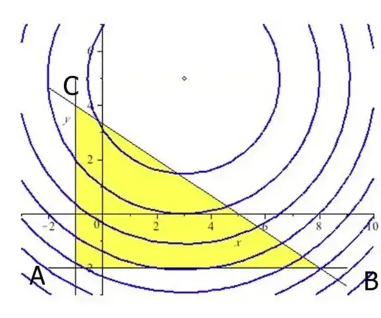

Often in calculus you are taught how to locate maxima and minima of functions of two variables using contour plots. I would like to write down and prove a precise statement about this way of identifying critical points. What kind of hypotheses do we need on the function? What is the exact meaning of sentences such as "all contours increase/decrease as we move toward the maximum/minimum"?

A contour is usually a curve on the plane and I have no idea what 'all contours (i.e. those curves) increase' might mean. I suppose it means 'whatever direction we choose, when approaching the maximum, we meet contours of increasing values' — but that's false, imho. The function $f(t)$, where $t$ is a position at a chosen line, needn't be strictly increasing on any interval $(t_0,t_{max}]$ to reach a maximum at $t_{max}$. Anyway, we needn't approach maximum along a straight line (move towards it) – we can approach it e.g. by a spiral... – CiaPan Jan 03 '18 at 14:00

It is a convenient method to find maxima and minima only for functions
$$f(x,y): D\subseteq \mathbb{R^2}\to \mathbb{R}$$
and only when the contur plots $f(x,y)=k$ have a simple representation in $\mathbb{R^2}$.
In this case the method consists simply to drawn in the plane the domain $D$ and the contour plots and by inspection to find the points of contact at wich $k_{max}$ and $k_{min}$ are attained.
