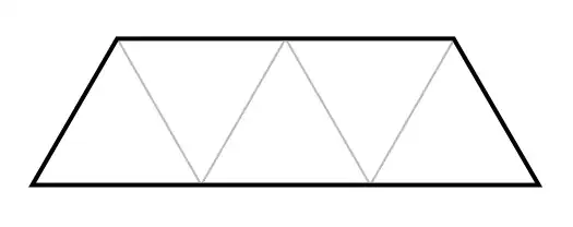

Can rotations and translations of this shape
perfectly tile some equilateral triangle?

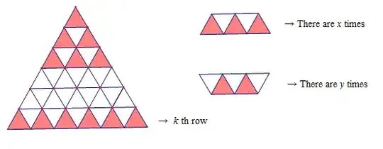

    Sorry, I didn' find anything. Lengt of a side of the big equilateral triangle is $n$. Therefore we have $n^2$ times unit equilateral triangles. In the figure, $k$-th row has $2k-1$ unit equilateral triangles. Let's paint with red color to $k$ times unit triangles and paint with white color to $k-1$ times unit triangles, in $k$-th row. enter image description here
    $x$ times part has $3$ red, $2$ white triangle. $y$ times part has $2$ red, $3$ white triangle.
    – scarface Apr 12 '17 at 01:39
    ... Number of all red triangles $$ 1+2+3+\cdots +n =\dfrac{n(n+1)}{2} $$ and number of all white triangles $$ 1+2+3+\cdots + (n-1) =\dfrac{n(n-1)}{2} $$ Hence, \begin{array}{lcl} 3x+2y & = & \dfrac{n(n+1)}{2} \ 2x+3y & = & \dfrac{n(n-1)}{2} \end{array}
    By adding these $5(x+y)=n^2$, $x+y=\dfrac{n^2}5$ and $5 \mid n$. Also we find that $x=\dfrac{n(n+5)}{10} $. But, these are not new things.
    – scarface Apr 12 '17 at 01:41

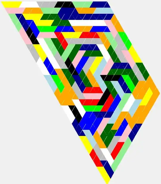

I suppose I should post: I solved this on MathOverflow. The answer is YES: a size-45 triangle can be tiled.
I thank two insights from Josh B here: first that a rhombus with side length 15 can be tiled, and second the strategy to "select a different shape which does tile a triangle, then tile that shape with our $5$ triangle trapezoid."
This $15-15-15-30$ trapezoid can be tiled, and three such trapezoids can tile a triangle with side length $45$.

    Thanks to you! How did you find that tiling? In the MathOverflow post you mention an SAT solver. Any more details? I had attempted this very search with BurrTools but it was going to take far too long. I think BurrTools gets in trouble when there are many ways to tile a subset of the full shape. For example, a rhombus of side length 5 can be tiled in two different ways. A parallelogram of lengths 5 and 6 can be tiled 4 ways. It only gets worse from there. – Josh B. Apr 17 '17 at 01:57
  • Thanks again. I added a picture of the solution to your answer because math.stackexchange answers are supposed to be self-contained. – Oscar Cunningham Apr 17 '17 at 07:06
  • Wonderful solution. Very entertaining how you reduced the problem to the case of three equilateral triangles. – Daniel Pietrobon Apr 17 '17 at 08:58
    @Josh B. Nothing special: I had one True/False variable for each possible tile placement, with the constraints "every triangle must be filled" and "any two overlapping tiles can't both exist." I wonder what techniques Burr Tools uses under the hood. An off-the-shelf SAT solver (pycosat) solved this in ~20 seconds, but would take a long time to solve a side-length-25 equilateral triangle. I'm guessing the limited width of the shape helps. – Lopsy Apr 17 '17 at 15:57

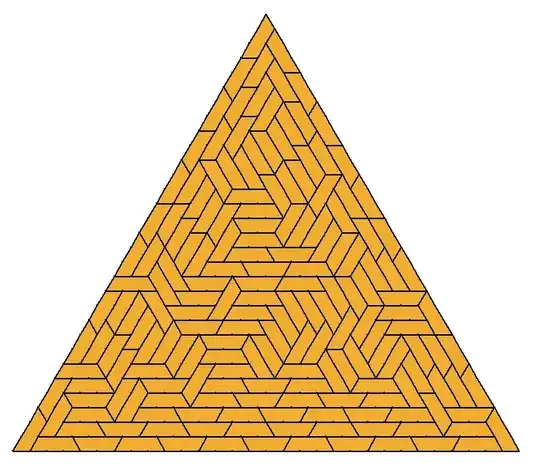

Here's the minimal solution, a side-30 triangle. Also posted to MathOverflow here https://mathoverflow.net/questions/267095/can-a-row-of-five-equilateral-triangles-tile-a-big-equilateral-triangle.enter image description here

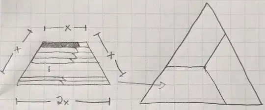

These trapezoids can be stacked and padded to tile a 1-1-1-2 ratio trapezoid. 3 of these mega-trapezoids tile an equilateral triangle.
Note that it's important for the trapezoid to have 21 rows (a multiple of 7) instead of 15 rows. Then the trapezoid can be "extended" by any integer length, by appending 21x1 parallelograms.

SAT-solver (glucose) + requiring rotational symmetry very quickly finds solutions for side-30. For example:
Without requiring symmetry, glucose took ~1 hour to find a solution. (Note that rotational symmetry requires side-length to be a multiple of 3 -- otherwise there is a central triangle).
