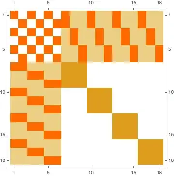

BTW, the Hessian looks as follows when evaluated with all values being 1. Four colors represent values 0,2,4,8 so that $H_{AB}$ consists of just 2's and 8's.
Mathematica code used to generate.
