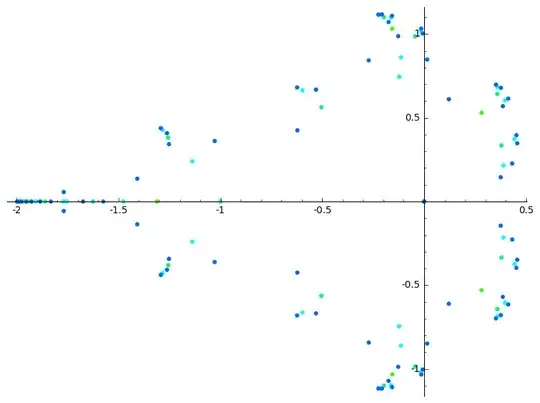

This is for the first 7 polynomials 7 poly

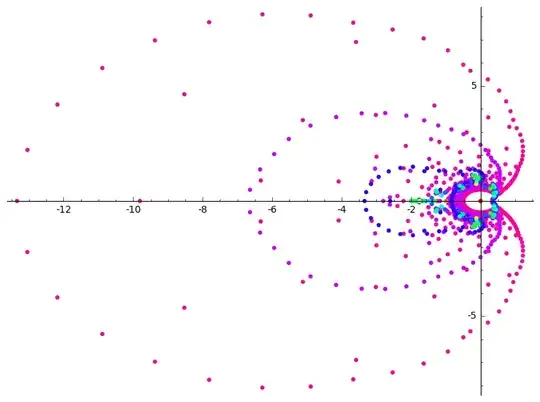

This is all 10 10 poly

This is just numerical error - a standard thing that you've got to get used to dealing with in this context. On my computer, the errors become apparent around 7 or 8 iterations. If you expand the polynomial at 8 iterations and check the largest coefficient, you should get 2676118542978972739644, which is larger than $2^{63}$ or the maximum machine integer. Mathematica and Sage can both deal with this but it's not automatic. You'll have to trigger extra precision somehow.
In Mathematica, you could do something like so:
f[c_][z_] = z^2 + c;
F[c][z_] = Nest[f[c], z, 8];
pts = c /. NSolve[F[c][0] == 0, c,
    WorkingPrecision -> 20];
ListPlot[{Re[#], Im[#]} & /@ pts,
 PlotRange -> All]
Notice the WorkingPrecision option. If you remove it, you'll find you get roots outside the disk of radius two. It quickly gets worse as the number of iterates increases.
