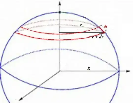

In order to give a short explanation of the mistake :
In writing $\quad 2 \int_{0}^{R} 2\pi r \text{ } dr \quad$ you sum elementary areas $\quad dA=2\pi\:r\:dr\quad$
that is to say, a strip length$=2\pi r$ and width$=dr$.
The hitch is that the width is not $dr$ but is $ds$ (see the figure).
With a few calculus, you can find $\quad ds=\frac{R}{\sqrt{R^2-r^2}}dr \quad\to\quad dA=2\pi\:r\frac{R}{\sqrt{R^2-r^2}}dr $
$$\quad 2 \int_{0}^{R} 2\pi\:r\frac{R}{\sqrt{R^2-r^2}}dr =4\pi R^2$$

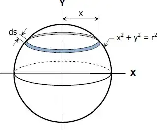

$$\text{Area will be}~~: 2 \int_{0}^{R} 2\pi x ~ ds$$
Where $ds$ is width of strip bounded by circles of radius $x$ and $x+dx$ situated at height $y$. Also $ds \neq dr$ it's tilted in $y$ direction too. Only horizontal projection of $ds$ is $dr$.What you have done is valid for Disk See image below.
$$(ds)^2=(dx)^2+(dy)^2$$
Therefore : $$ds = \sqrt{1+\Bigg( \frac{dy}{dx}\Bigg)^2} \; dx$$ Now,
$$x^2 + y^2 = R^2$$ $$y = \sqrt{R^2 - x^2}$$ $$\dfrac{dy}{dx} = \dfrac{-2x}{2\sqrt{R^2 - x^2}}$$ $$\dfrac{dy}{dx} = \dfrac{-x}{\sqrt{R^2 - x^2}}$$ $$\left( \dfrac{dy}{dx} \right)^2 = \dfrac{x^2}{R^2 - x^2}$$
Thus, $$\displaystyle A = 4\pi \int_0^R x \sqrt{1 + \dfrac{x^2}{R^2 - x^2}} \, dx$$ $$\displaystyle A = 4\pi \int_0^R x \sqrt{\dfrac{(R^2 - x^2) + x^2}{R^2 - x^2}} \, dx$$ $$\displaystyle A = 4\pi \int_0^R x \sqrt{\dfrac{R^2}{R^2 - x^2}} \, dx$$
Let $$x = R \sin θ \implies dx = R \cos θ dθ$$
When $x = 0, θ = 0$ When $x = R, θ = \pi/2$
Thus, $$\displaystyle A = 4\pi \int_0^{\pi/2} R \sin \theta \sqrt{\dfrac{R^2}{R^2 - R^2 \sin^2 \theta}} \, (R \cos \theta \, d\theta)$$ $$\displaystyle A = 4\pi \int_0^{\pi/2} R^2 \sin \theta \cos \theta\sqrt{\dfrac{R^2}{R^2(1 - \sin^2 \theta)}} \, d\theta$$ $$\displaystyle A = 4\pi R^2 \int_0^{\pi/2} \sin \theta \cos \theta\sqrt{\dfrac{1}{\cos^2 \theta}} \, d\theta$$ $$\displaystyle A = 4\pi R^2 \int_0^{\pi/2} \sin \theta \cos \theta \left( \dfrac{1}{\cos \theta} \right) \, d\theta$$ $$\displaystyle A = 4\pi R^2 \int_0^{\pi/2} \sin \theta \, d\theta$$ $$A = 4\pi R^2 \bigg[-\cos \theta \bigg]_0^{\pi/2}$$ $$A = 4\pi R^2 \bigg[-\cos \frac{1}{2}\pi + \cos 0 \bigg]$$ $$A = 4\pi R^2 \bigg[ -0 + 1 \bigg]$$ $$A = 4\pi R^2$$
