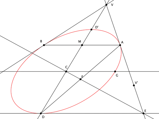

I found a way to do this construction in a purely geometrical way, without coordinates. Let $A$, $B$ be the given tangency points (called $\mathbf p_1$ and $\mathbf p_2$ in the question) and $AV$, $BV$ the corresponding tangents (the case when tangents are parallel can be dealt with in a simpler way, see below).
If $M$ is the midpoint of $AB$, for a well-known property of the ellipse line $VM$ is a diameter, and we are free to choose on it a point $D$, to construct the ellipse touching the given tangents at $A$, $B$ and passing through $D$. The construction is quite simple, because the line through $D$ parallel to $AB$, meeting line $VA$ at $E$, is another tangent: if $F$ is the midpoint of $AD$ it follows that $EF$ is also a diameter, and the intersection $C$ of $VM$ and $EF$ is thus the center of the ellipse (see diagram). With the center and three points, the ellipse can be easily constructed.
But of course we must choose point $D$ such that the eccentricity of the ellipse be minimum. To that end, draw line $GC$ parallel to $AB$ and notice that lines $CD$ and $CG$ form a pair of conjugate diameters. Apollonius' equations connect semidiameters $CD$ and $CG$ with standard semiaxes $a$ and $b$ of the ellipse: $$ CD^2+CG^2=a^2+b^2,\quad CD\cdot CG\sin\theta = ab, $$ where $\theta=\angle VMA$. From there it is not difficult to find an expression for the eccentricity $\epsilon$ as a function of $t=CD/CG$: $$ \epsilon^2={2\over1+1/\xi}, \quad\hbox{where}\quad \xi=\sqrt{1-\left({2t\over1+t^2}\right)^2\sin^2\theta}. $$ It follows that
the minimum value of the eccentricity, $\epsilon=\sqrt{2\over1+1/|\cos\theta|}$, is obtained when $CD=CG$.
To exploit that condition, notice that $(AM/CG)^2+(CM/CD)^2=1$ and if $CD=CG$ this is equivalent to $$ AM^2+CM^2=CD^2. $$ Playing around with similar triangles one also finds $CD/MC=1+VM/MD$: combining those equalities we finally get $$ MD={AM^2+AM\sqrt{AM^2+VM^2}\over VM}. $$ From that, one can construct point $D$ and then find center $C$ as explained above.
If tangent lines are parallel, $A$ and $B$ are the endpoints of a diameter and center $C$ is their midpoint. Just construct then the conjugate diameter through $C$ parallel to the tangents and take on it point $D$ such that $CD=AC$.
