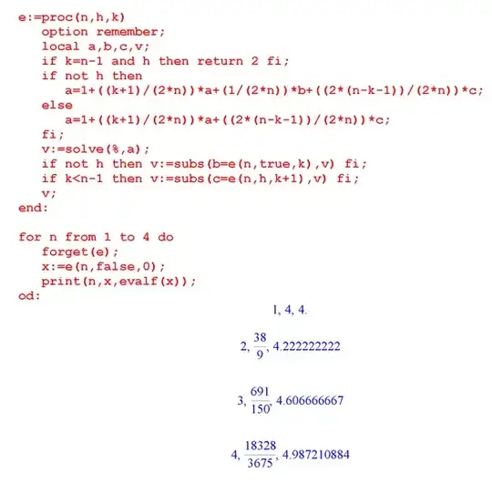

  • @vamsikal: For a given n. I can get the exact answers with a program. Do you have any reason to believe that there's a closed form? – quasi Mar 11 '17 at 06:47
  • I am not sure whether there is a closed-form. But I would be very interested in the algorithm for computing the correct answer for a given n. – vamsikal Mar 11 '17 at 06:51
  • @vamsikal: I'll post my code as an answer in a few minutes. – quasi Mar 11 '17 at 06:58

Here's my revised implementation in Maple, hopefully now correct. enter image description here

Edit: The exponential generating function $\sum_{m=0}^\infty b_r^{(m)}\frac{x^m}{m!}=(e^x-1)^r$. From this we find the egf of $(I_m)$ is $$(1+x)e^x[2e^x-1]^{n-1} = (1+x)\sum_{k=1}^{n}{{n-1}\choose {k-1}}(-1)^{n-k}2^{k-1} e^{kx}$$ Then we use Laplace transforms to find the ordinary generating function $$I(s) = \sum_{m=0}^\infty I_m s^m = \sum_{k=1}^n{{n-1}\choose{k-1}}(-1)^{n-k}2^{k-1}\left[\frac{1}{1-sk}+\frac{s}{(1-sk)^2}\right]$$ and if we let $s=x/(2n)$ we get $$I(x) = n\sum_{k=1}^n{{n-1}\choose{k-1}}(-1)^{n-k}2^{k}\left[\frac{1}{2n-xk}+\frac{x}{(2n-xk)^2}\right]$$ From our initial definitions we find $$P(x)=\sum_{m=0}^\infty \frac{a_m}{(2n)^m}x^m=1-(1-x)I(x)$$ Then our expected value, in closed form, is $$E(n)=P'(1)=n\sum_{k=1}^n{{n-1}\choose{k-1}}(-1)^{n-k}2^{k}\left[\frac{1}{2n-k}+\frac{1}{(2n-k)^2}\right]$$ $E(1)=4$ and $E(2)=\frac{38}{9}=4.222$, as expected. We also find $E(3)=\frac{691}{150}=4.607$, $E(4)=\frac{18328}{3675}=4.987$, and $E(5)=\frac{424367}{79380}=5.346$.
