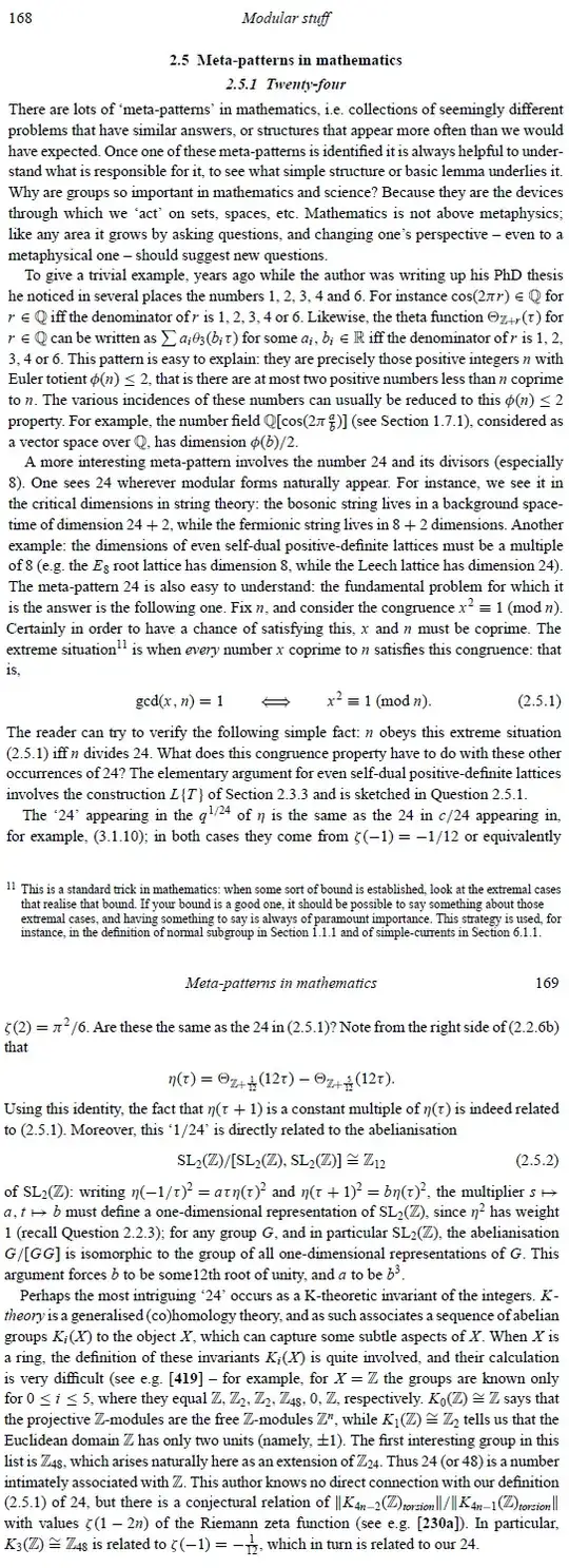

I believe I've tracked down what Qiaochu was referencing in Gannon's Moonshine beyond the Monster, pg168-169 ยง2.5 (alas, five pages too late). I can't claim to understand any of it.
$\qquad$ 24
