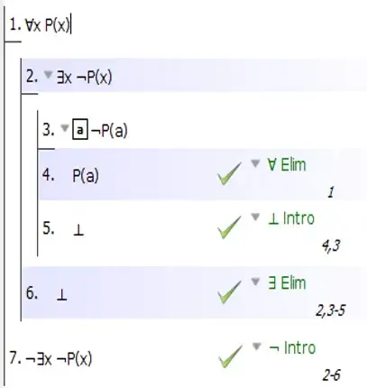

Different systems define the Existential Elimination (or Existential Instantiation) differently, but here is a proof in the Fitch system I use:
EDIT
OK, so your system is indeed a good bit different from the one I use above. Here is a proof in your system:

  • I'm sorry that I'm not familiar with your system's notation. Is step 3 equivalent to $\forall a \neg P(a)$? – Han Feb 25 '17 at 05:41
  • @Han Yeah, I was afraid your system might be different ... How is your Existential Elimination rule defined? ... And no, you don't want to use $\forall a \neg P(a)$, since $a$ is a constant, and you can only quantify over variables. – Bram28 Feb 25 '17 at 13:32

  • @Han. I really doubt that that is how EE is defined ... i have seen many different particular implemenations of EE, but I have never seen anyone that requires you to have a $\forall$. indeed, how would you infer $\exists x (P(x) \land Q(x))$ from $\exists x (Q(x) \land P(x))$ using this as the EE rule? Also, no, the figure I show is not just a workflow ... It does have all the details for the particular proof system I work with. – Bram28 Feb 25 '17 at 18:25
  • Sorry for the late response. This EE is defined under http://logic.stanford.edu/intrologic/notes/chapter_08.html. This definition seemed like Or Elimination. The question you proposed is solvable in this case, s.t. assume $Q(x)\wedge P(x)$ then using EI to obtain $Q(x)\wedge P(x) \Rightarrow \exists x.(P(x)\wedge Q(x))$. Then using UI to introduce the $\forall$ symbol. Last step is a direct application of EE. – Han Feb 26 '17 at 02:38
  • @Han Huh! I must say, I have never seen such an implementation of EE! But you're right, it does indeed require a universal! Well, OK, no worries, my proof can easily be modified to fit your format.: On line 6, use $\forall : I$ On the subproof to get $\forall x (\neg P(x) \rightarrow \bot)$. Then on line 7, use EE on lines 2 and 6 to get $\bot$. And line 8 will be like the original line 7. – Bram28 Feb 26 '17 at 02:51

  • @Han Do you have the contradiction ($\bot$)? And can you maybe send me a link to the propositional logic rules? – Bram28 Feb 26 '17 at 05:10
  • We do not have the contradiction symbol, yeah, that's the main part that I was stuck. I think most of the rules can be checked with this url: http://logic.stanford.edu/intrologic/glossary/glossary.html. It seemed that rules about $\forall$ and $\exists$ were excluded, both of them can be seem from here: http://logic.stanford.edu/intrologic/notes/chapter_08.html – Han Feb 26 '17 at 05:38
  • @Han Oh boy! They're not making this easy, do they?! Anyway, let me modify my proof yet again! – Bram28 Feb 26 '17 at 06:10
  • @Bram28, yeah, this might be the hardest one for this problem set. I don't know why the discussion forum was removed, and I was stuck almost a week or so... – Han Feb 26 '17 at 08:12
  • @Bram28: You may be interested to know that it is easiest to use such an existential elimination rule to represent Fitch-style natural deduction in a sequent calculus like in this post. I also found a very very brief summary of many ND systems at http://ualberta.ca/~francisp/papers/pelletierNDtexts.pdf – user21820 Feb 26 '17 at 08:26
  • @Han Holy cow! I got it, but that was a major pain!! What a sadistic system of rules. :( That EE rule requiring you to have a universal makes for quite roundabout proofs, and the same goes for not having an explicit $\bot$ and associated rules. Look how much easier this is in the system I use.... Oh well! – Bram28 Feb 26 '17 at 14:22
