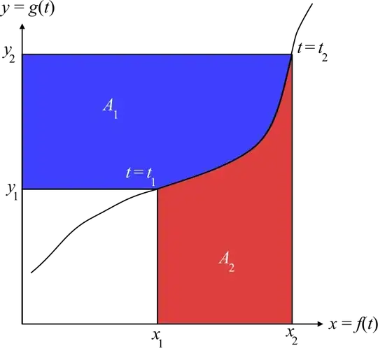

Integration by parts - visualization
Not that shocking, but my teacher never showed me this. For many people this will be familiar, but for those who never saw it: it can be an eye opener.
Image source: Wikipedia
The area of the blue / red region is:
$$A_1=\int_{y_1}^{y_2}x(y)dy$$
$$A_2=\int_{x_1}^{x_2}y(x)dx$$
So we have:
$$\overbrace{\int_{y_1}^{y_2}x(y)dy}^{A_1}+\overbrace{\int_{x_1}^{x_2}y(x)dx}^{A_2}=\biggl.x > . y(x)\biggl|_{x1}^{x2} = \biggl.y . x(y)\biggl|_{y1}^{y2}$$
Assuming the curve is smooth within a neighborhood, this generalizes to indefinite integrals:
$$\int xdy + \int y dx = xy$$
Rearranging yields the well-known formula:
$\int xdy = xy - \int y dx$
