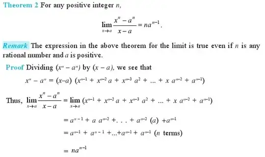

I am not getting how they factorised the $x^n-a^n$ term?
- 44,997
1What are you not getting? The factorization is right there, on the line below the blue "Proof". Do you deny that the product of the two factors is $x^n-a^n$? – hmakholm left over Monica Feb 19 '17 at 13:27
It is, but to be honest, that explanation only shows the check that the long division is correct. It doesn't really go into the division itself. – Daniel Goldman Feb 19 '17 at 13:34
This is a high-school identity. It is derived from the factorisation: $;1-x^n=(1-x)(1+x+x^2+\dots+x^{n-1})$ which is the basis for the sum of the geometric series, and is easily proved by induction. – Bernard Feb 19 '17 at 13:36

Lets do it backwards for a special case . You have the sum of powers
$$1+x+x^2+\cdots +x^{n-1}.$$
Multiply this by $x$ and you get
$$x+x^2+x^3+\cdots+x^n.$$
You find that increasing the exponent of each term by $1$ essentially did nothing else but removing the $1$ from the beginning and adding the $x^n$ at the end. Every term in between is contained in both sums. This means we can get the second form from the first one by the following operation instead:
$$x\cdot (1+x+\dots+x^{n-1})=(1+x+\dots+x^{n-1})+(x^n-1).$$
The left side is what we already did before, the right side expresses the removing of $1$ and adding of $x^n$ instead. Now do some rearrangement:
\begin{align} (1+x+\dots+x^{n-1})+(x^n-1) &= x\cdot (1+x+\dots+x^{n-1})\\ x^n-1 &= x\cdot (1+x+\dots+x^{n-1}) - (1+x+\dots+x^{n-1})\\ x^n-1 &= (x - 1)\cdot (1+x+\dots+x^{n-1}).\\ \end{align}
This already looks like the identity you are looking for, with the special assumption $a=1$. Lets generalize:
\begin{align} x^n-a^n &= a^n\left(\left(\frac xa\right)^n-1\right)\\ &\overset{(*)}= a^n\left(\frac xa-1\right)\left(1+\frac xa+\left(\frac xa\right)^2+\cdots +\left(\frac xa\right)^{n-1}\right) \\ &= a\left(\frac xa-1\right) \cdot a^{n-1}\left(1+\frac xa+\left(\frac xa\right)^2+\cdots +\left(\frac xa\right)^{n-1}\right) \\ &=(x-a)(a^{n-1}+ x a^{n-2} +\cdots x^{n-2}a + x^{n-1}). \end{align}
In step $(*)$ I used the special case and $x\mapsto \frac xa$ to expand the latter term.
