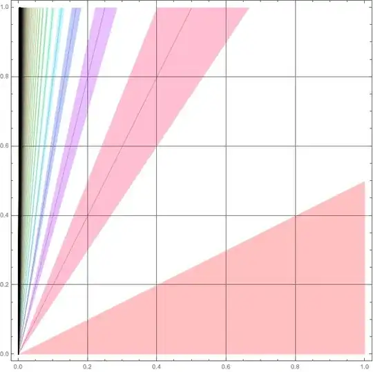

The solution becomes obvious if we look at a graph of $(B,A)$ in the Cartesian unit square $[0,1]^2$. Then the value $A/B$ is the slope of the line segment joining $(B,A)$ to the origin. Define $[x]$ to indicate the nearest whole number to $x$. Then clearly, when $A < B$, we must have $[A/B] = 0$, which occurs for points in the triangle with vertices $\{(0,0), (1,0), (1,1/2)\}$. This triangle has area $1/4$.
For points with $A > B$, we have an infinite series of triangles with variable base along the edge joining $(0,1)$ and $(1,1)$, and common height $1$. For a point $(x,1)$ along this edge, the rounded slope is $[1/x]$, and we require this to be an even integer; i.e., $$2k - 1/2 < 1/x < 2k + 1/2, \quad k \in \mathbb Z^+$$ or equivalently $$\frac{2}{4k+1} < x < \frac{2}{4k-1}.$$ Consequently the total area of these triangles is simply $$\frac{1}{2} \sum_{k=1}^\infty \frac{2}{4k-1} - \frac{2}{4k+1} = \sum_{m=1}^\infty \frac{(-1)^{m+1}}{2m+1} = 1 - \frac{\pi}{4}.$$ Adding in the value for the case $[A/B] = 0$, we get $$\frac{5-\pi}{4} \approx 0.46460183660255169038.$$ Your answer corresponds to the case where $[A/B]$ is a positive even integer.
