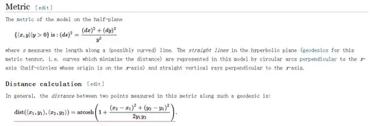

As in wiki,the distance function is
I don't know how to get this formula, I mean how to prove it.

    If forced to construct a clean proof from scratch off the top of my head, I'd use a Möbius transformation preserving the upper half-plane (i.e., a hyperbolic isometry) to send $p = (x_1, y_1)$ and $q = (x_2, y_2)$ to $(0, 1)$ and a point $(0, y)$ respectively, then perform the easy length integral along the vertical axis. – Andrew D. Hwang Feb 11 '17 at 13:47

    @AndrewD.Hwang I think this question is not duplicate with Expression of the Hyperbolic Distance in the Upper Half Plane . Because I want to know how to prove it . In the answers of Expression of the Hyperbolic Distance in the Upper Half Plane, just prove two expression are equal. – Enhao Lan Feb 12 '17 at 13:15
  • @lanse7pty: Will Jagy's answer to the linked question gives a good strategy, but I agree that the accepted linked answer does not address your question, and have voted to re-open. – Andrew D. Hwang Feb 12 '17 at 14:15
