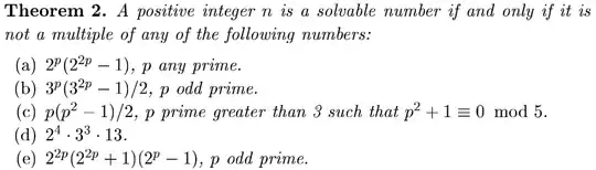

For solvable numbers, see the last theorem in the paper Nilpotent and solvable numbers by Pakianathan and Shankar:
(also J. Pakianathan and K. Shankar, Nilpotent numbers, Amer. Math. Monthly, 107, August– September 2000, 631–634)
