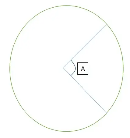

One of my friends gave me this problem. Initially I thought that this would be easy but i tried this for two days unable to do this in a proper manner.
There is a circle with an angle A located at the center of the circle
Prove that: $\sin A < A < \tan A$

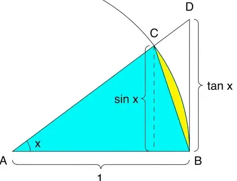

enter image description here The area of $\triangle ABC$ is $\frac{1}{2}\sin(x)$. The area of the colored wedge is $\frac{1}{2}x$, and the area of $\triangle ABD$ is $\frac{1}{2}\tan(x)$. By inclusion, we get $$ \frac{1}{2}\tan(x)\ge\frac{1}{2}x\ge\frac{1}{2}\sin(x)\tag{1} $$
