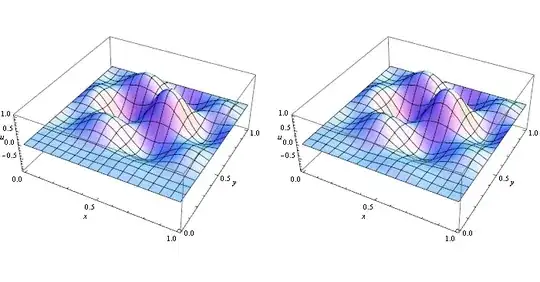

As a specific example, we can think of the following expansion as a two dimensional Fourier sine series for $f(x,y)$ on $0<x<a$, $0<y<b$: $$ f(x,y)=\sum_{n=1}^\infty \sum_{m=1}^\infty c_{nm}\sin\left({n\pi\, x\over a}\right)\sin\left({m\pi\, y\over b}\right), \quad 0<x<a,\ 0<y<b, $$ where the coefficients (obtained from the same type of orthogonality argument as in the 1D case) are given by \begin{align} c_{nm}&={\int_0^b \int_0^a f(x,y)\sin\left({n\pi\, x\over a}\right)\sin\left({m\pi\, y\over b}\right)\,dx\,dy\over \int_0^b \int_0^a \sin^2\left({n\pi\, x\over a}\right)\sin^2\left({m\pi\, y\over b}\right)\,dx\,dy}\\ &={4\over a b}\int_0^b \int_0^a f(x,y)\sin\left({n\pi\, x\over a}\right)\sin\left({m\pi\, y\over b}\right)\,dx\,dy, \quad n,m=1,2,3,\dots \end{align}
For example, the picture below shows (left) the surface $$f(x,y)=30x y^2 (1-x)(1-y)\cos(10x)\cos(10y), \quad 0<x<1,\ 0<y<1,$$ and a plot of the two dimensional Fourier sine series (right) of $f(x,y)$ for $n,m,=1,\dots,5$:

  • This representation seems to be valid only if the values of the function on the boundary of the rectangle are zero. – Beni Bogosel Nov 13 '13 at 11:59
  • Yes, that's why I said, "As a specific example..." The sine functions used there are the eigenfunctions obtained when solving the heat equation on a rectangle where zero boundary conditions are specified. – JohnD Nov 14 '13 at 00:47
