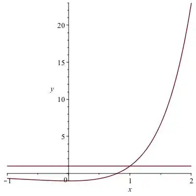

I quite liked your question so thought this might be of assistance next time you face a question similar to this one you can employ some mathematical software to help for e.g. Maple. You can rewrite the equation to look like this $$ f(x) = g(x) $$ where $f(x)= 6^x - 3^x -2^x$ and $g(x)=1$ is a constant function. So it's an intersection problem. The graph is below.
Clearly, they intersect at $x=1$ or you can use the following code to be $100\%$ sure
fsolve({f(x) = g(x)}, {x}, x = -1 .. 2)
where $f(x)$ and $g(x)$ are defined as above.
