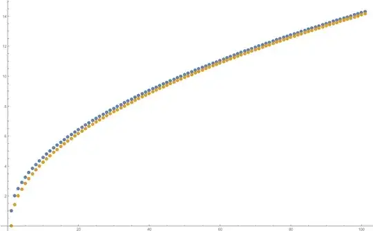

Thanks to Clement C., here it is a plot of $a_n$ versus $\sqrt{2n}$:

    Not sure how you feel about including empirical confirmation, but if you want to include this (plot of $a_n$ vs. $\sqrt{2n}$ for $0\leq n\leq 100$) in your answer, feel free to: https://s30.postimg.org/5800t2dy9/an_vs_sqrt2n.png – Clement C. Jan 24 '17 at 00:43
  • @ClementC.: many thanks, where may I give a (+1) for the contribute? – Jack D'Aurizio Jan 24 '17 at 00:49
  • Nowhere needed -- I had made a plot, might as well not let it be wasted. – Clement C. Jan 24 '17 at 00:50
