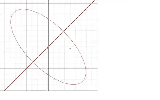

This ellipse is centered at the orgin.
The distance you seek equals the length of the minor axis.
Next thing to know is that it has been rotate 45 degrees.
$x = \frac {\sqrt 2}{2} x' + \frac {\sqrt 2}{2} y'\\ y = -\frac {\sqrt 2}{2} x' + \frac {\sqrt 2}{2} y'$
Will rotate it into standard position.
Or, the egienvalues of $\begin{bmatrix} 3&2\\2&3\end{bmatrix}$ are $1$ and $5$
$x'^2 + 5y'^2 = 20\\ \frac {x'^2}{20} + \frac {y'^2}{4} = 1$
$2$
Doug M
  • 57,877
By inspection (or see this for additional reference if required), we can see that this is an ellipse with centre at origin and axes of symmetry $y=\pm x$. Substituting into the ellipse equation gives end points of minor and major axes respectively: $$\\\begin{align} 3x^2\pm 4x^2+3x^2&=20\\ 2x^2, 10x^2, &=20\\ x&=\pm\sqrt{2}, \pm\sqrt{10}\end{align}$$ Distance from origin to semi-major/semi-minor axes is given by $\sqrt{x^2+y^2}=|x|\sqrt{2}$.
Shortest distance from origin to ellipse is semi-minor axis, i.e. $$\sqrt{2}\cdot \sqrt{2}=\color{red}2$$

Taking into account that it is an ellipse with short axis $y=x$ find crossings of this line with the ellipse.
