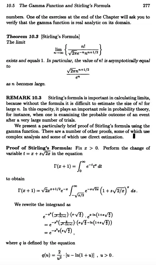

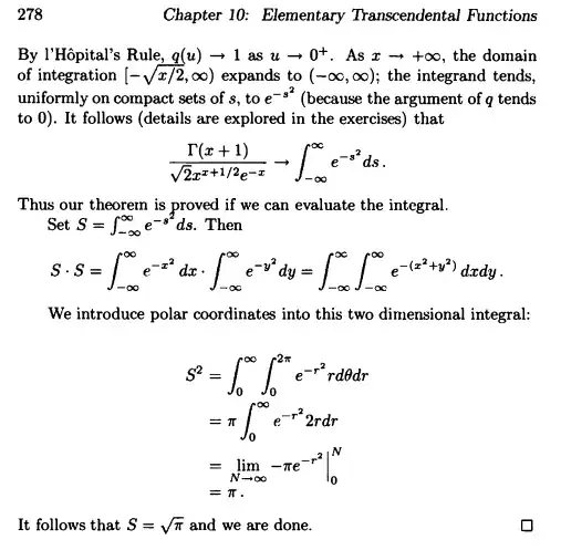

You may find a "simple" or better well written proof in the book Real Analysis and Foundations from Steven G. Krantz (p. 277 and 278) which you may find. As far as I can see, he uses the Gamma function, l'Hopital's rule and the evaluation in polar coordinates of $$\int_{-\infty}^\infty e^{-s^2} ds$$
- 7,869
That is a weird source. The limit argument on top of page 278 needs dominated convergence theorem, and finding the integrable majorant function is not so easy. By the way: the details seem not to exist n the exercises ... – Eric Feb 22 '21 at 10:45
