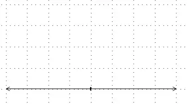

We can imagine the set of natural numbers as an axis that goes from some fixed point ($0$, or $1$ if you want) to infinity:
Clearly, the points on this axis are countable, because we know exactly how the axis goes on and can therefore make a precise calculation about how many points the rest of the axis will contain.
For the integers, we no longer have a fixed starting point, but the axis grows infinitely in two directions:
However, we still have only one axis of fixed points and can make a precise calculation of how many points the axis as a whole will contain.
The first thing that bugs me: Since the axis is calculably exactly twice as long, this should be a "larger infinity" than the for the natural numbers, right? But still, we would say that $\mathbb{Z}$ has the same cardinality as $\mathbb{N}$?
